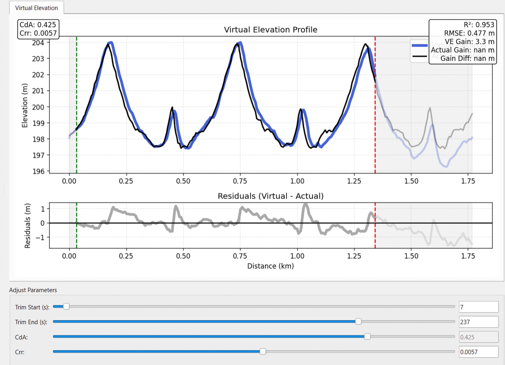

With a wheel speed sensor, power meter, scale, and known air density, the Chung Method can flip the script on its typical use to sort out the coefficient of rolling resistance (Crr) on or off-road. With these known values, including perhaps an initial approximation of CdA or aerodynamic drag, a rider can do laps without using their brakes on a course of about 1 km and get a calculation of Crr within Golden Cheetah or better yet, a GitHub Virtual Elevation Analyzer created by another Escape Collective member (Thanks, Hannes!)
Performance Process: MTB v gravel tyre testing & how to DIY-test your setup
Wide tyres have taken gravel racing by storm, but are they actually faster? Novel real-world testing shows the first hint that there’s a real performance advantage.
Essentially, this method recreates the actual elevation profile of the test ride laps. I used USGS files of one meter DEM elevation data overlaid in most of these tests for absolute certainty, as GPS elevation can be a bit off as we have all seen in our ride uploads. I know it sounds odd, but it uses calculations for every one-second interval of a .fit file so the outcome is very robust. This contrasts with the initial simplicity of comparing Strava segments, which fall short of showing you with absolute certainty how you were a little faster on this day vs. that day. Regardless of method, any testing should be repeatable to a high degree of accuracy, which means a few laps of both 29" and 32" conditions in this case.
Matching squiggly lines is the goal.

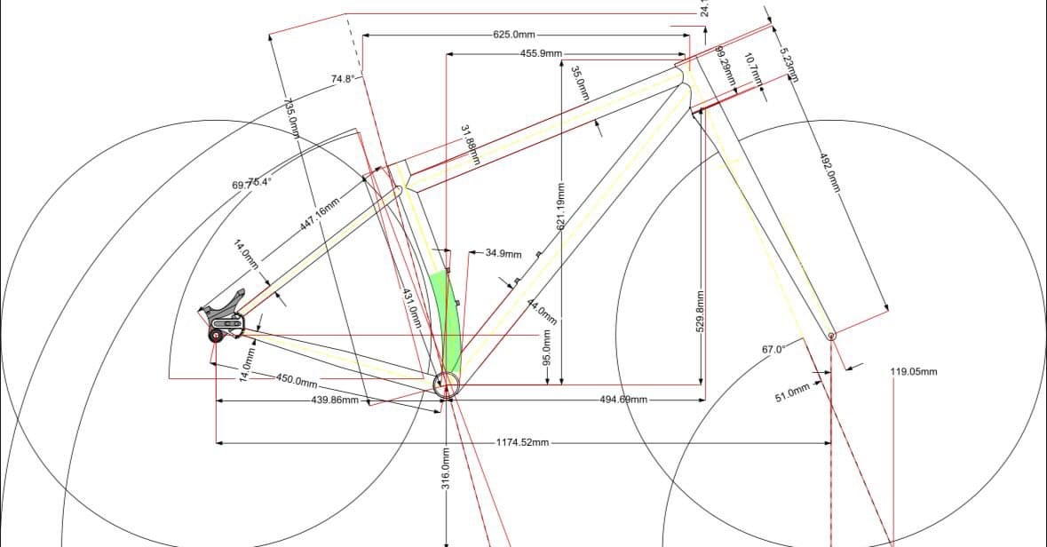

Geometry chart for Vassago Ti Prototype no. 2.
For some context on the geometry, I am 175 cm (5’ 9”) tall with an 84 cm inseam and ride a 73.5 cm seat height with 175 mm crankarms. I do yoga and have been riding since 1999, so the bars are maybe on the low side visually, but the fit is comfortable for me and has worked well in 100-mile races.

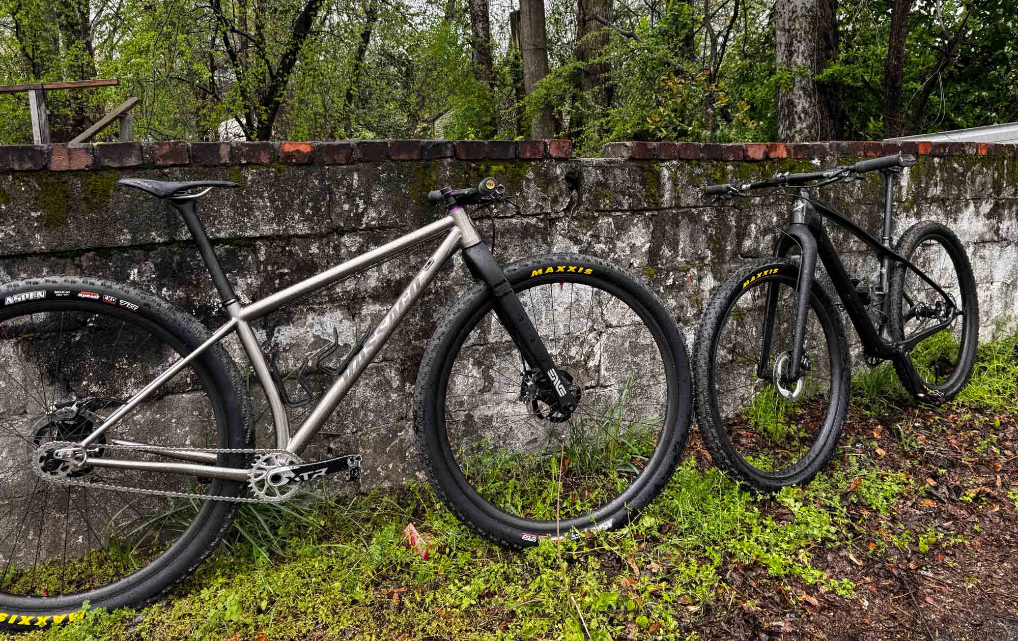

Late last year, a fellow singlespeed nutter Rich Dillen gave me a tip that I should talk to Tom at Vassago Cycles about one of the titanium prototype frames he was building. These were one-off non-suspension corrected frames built around a carbon 29er fork that cleared a 32 x 2.4" tire. Rich had already ordered his and the geometry had some key features I wanted including a bottom bracket drop figure in the low 90 mm range. Daniel Yang and Neuhaus Metalworks were also initial inspirations for the whole project. The 32" Nova from Neuhaus just had this look to it that captivated me (something Josh Weinberg is currently also testing for Escape Collective). Somehow, certain bikes take you back to being a 15-year-old kid looking at your dream bike in a catalog. I told Tom I was in and started planning the rest of my big wheel machine.
Here are the full specs on each bike. I have included all relevant details for transparency, as there are a couple of differences between them, such as spoke count and spoke type. Subjectively, they are both fantastic bikes, and I think they give a reasonable real-world comparison of 29" vs 32" mountain bikes.

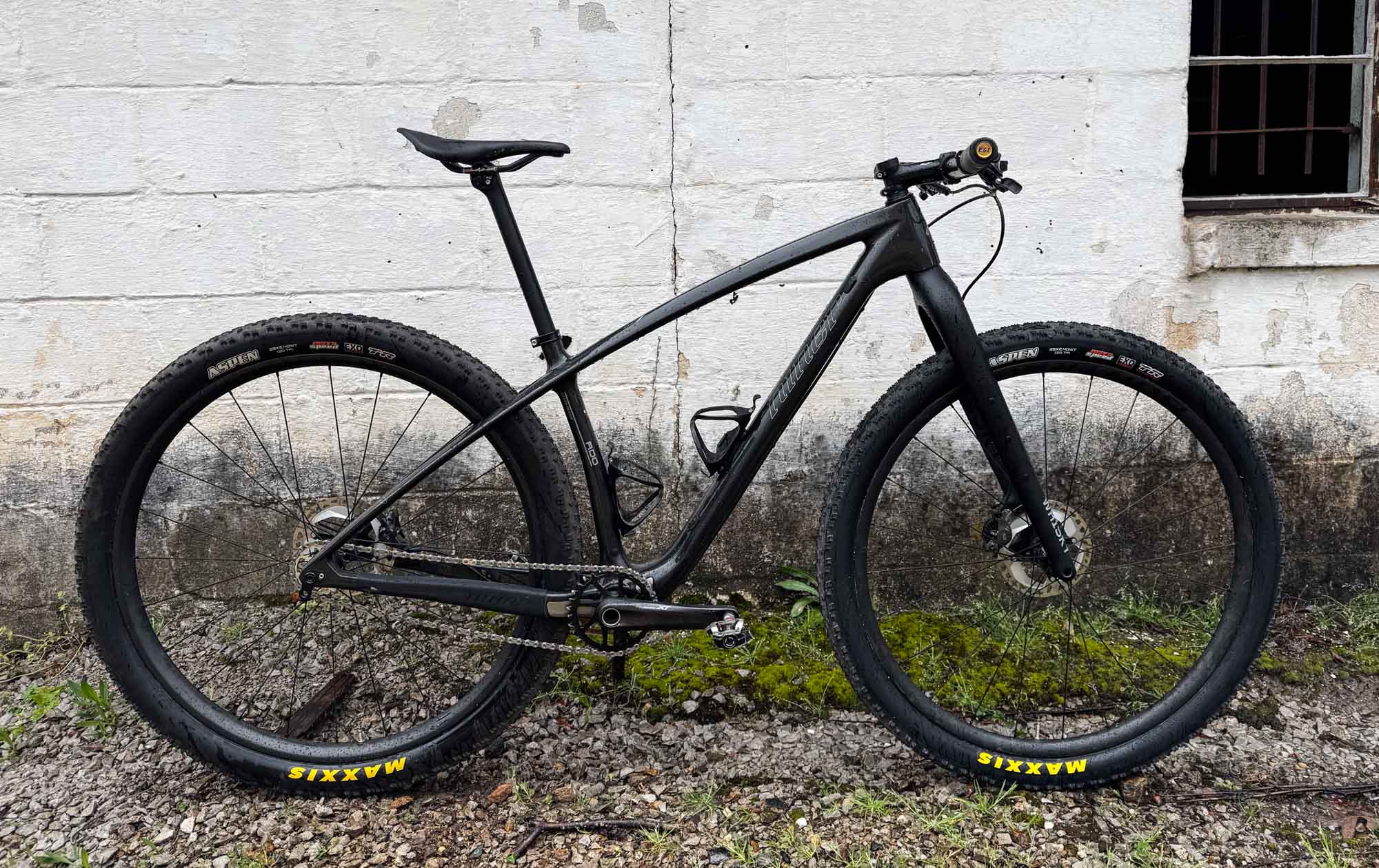

29" Build
The 29er.

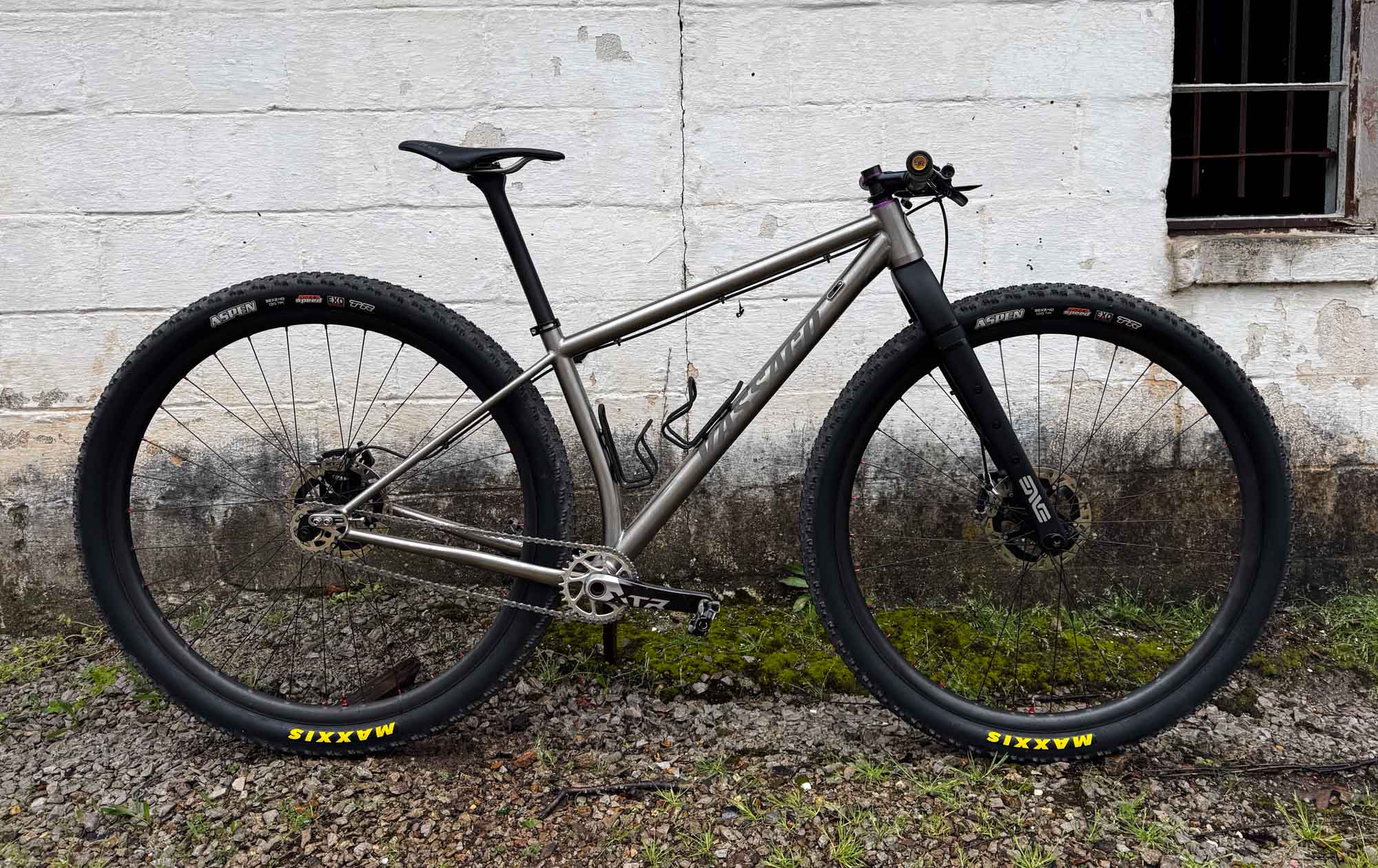

32" Build
The 32er.

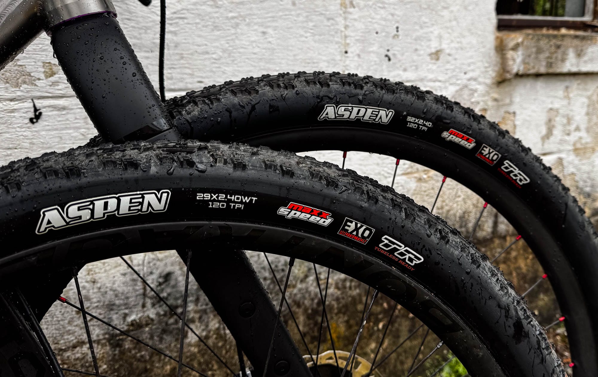

Tire pressure notes: For the Smooth Pavement testing I ran 24/26 psi in the 29" and 23/25 psi in the 32". For all other gravel and cobble testing I ran 16/18 psi in the 29" and 15/17 psi in the 32". This seems to give a similar tire deformation between the two sizes and is in line with Wolf Tooth’s tire pressure calculator that was recently updated to include 32" tires.
