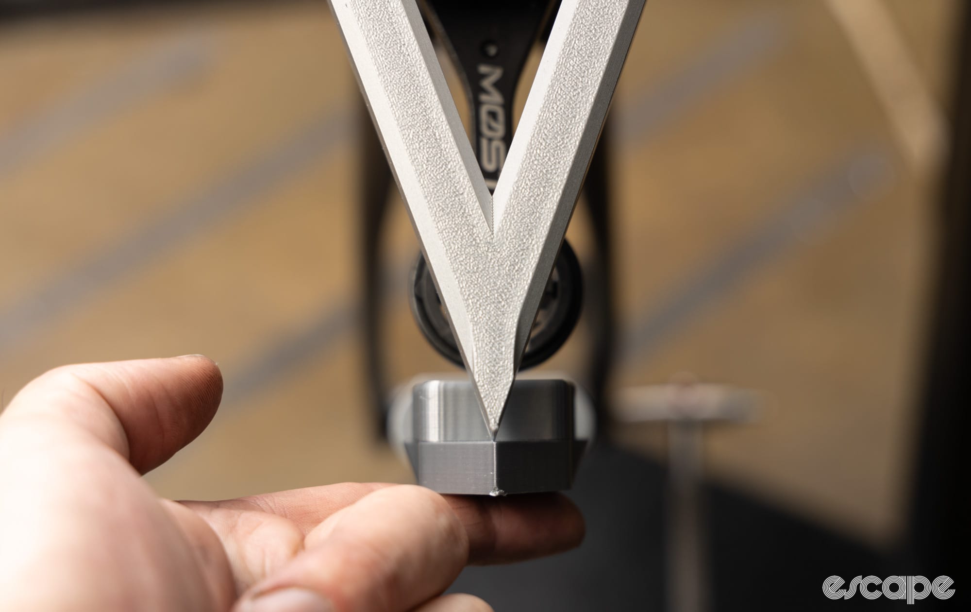

VeloTechnics
Based near Geelong, Victoria, Chris Fry of VeloTechnics spent years building bikes for Baum Cycles, and is likely a familiar mechanic for many in the WorldTour who visit Australia each January.
Soft-launched this year, VeloTechnics’ first product is a handlebar alignment tool that uses the fork dropout as the base. It’s a sensible place to do the alignment from, but it’s not the simplest thing to design for.
