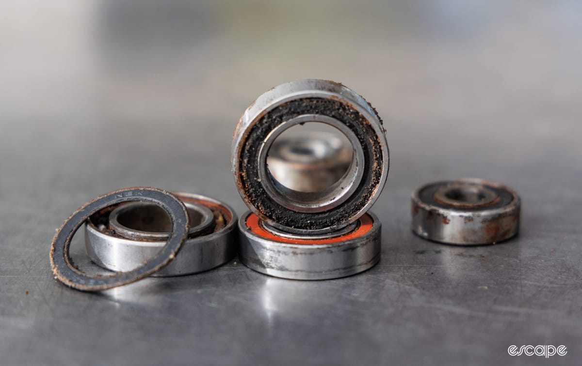

When it comes to removing cartridge bearings (aka sealed bearings), the humble punch and hammer may get the job done, but there are better options for smooth removal that reduce the risk of them falling apart or damaging the component they sit within.

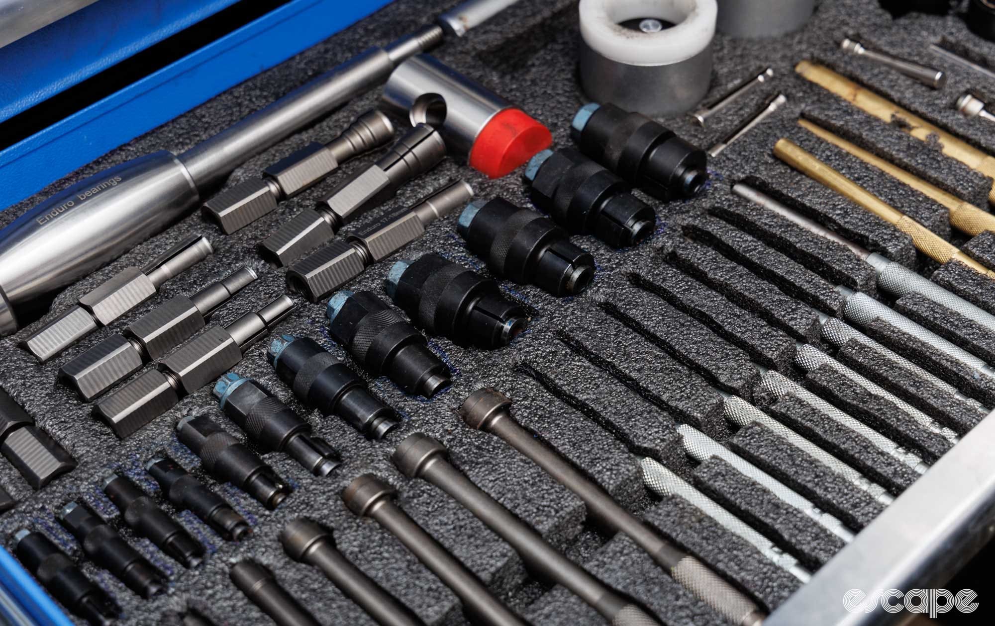

It’s now been two years since I covered this topic in Threaded and there’s been a handful of new tool entrants into the space. So, with that, I thought it was time to revisit the topic of expanding bearing pullers suited to hub and frame pivot bearings (and sometimes more), showing you what options exist, how they work, and providing thoughts on how well they work.

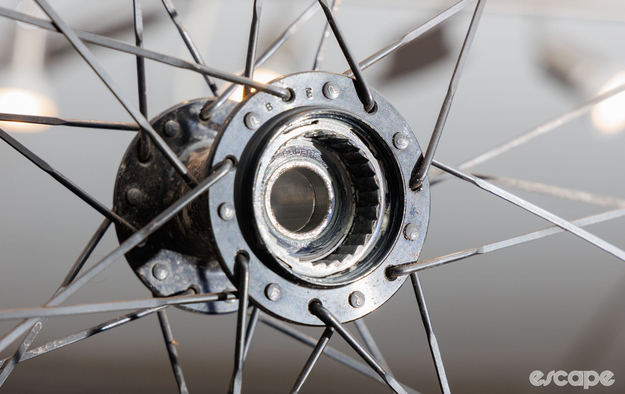

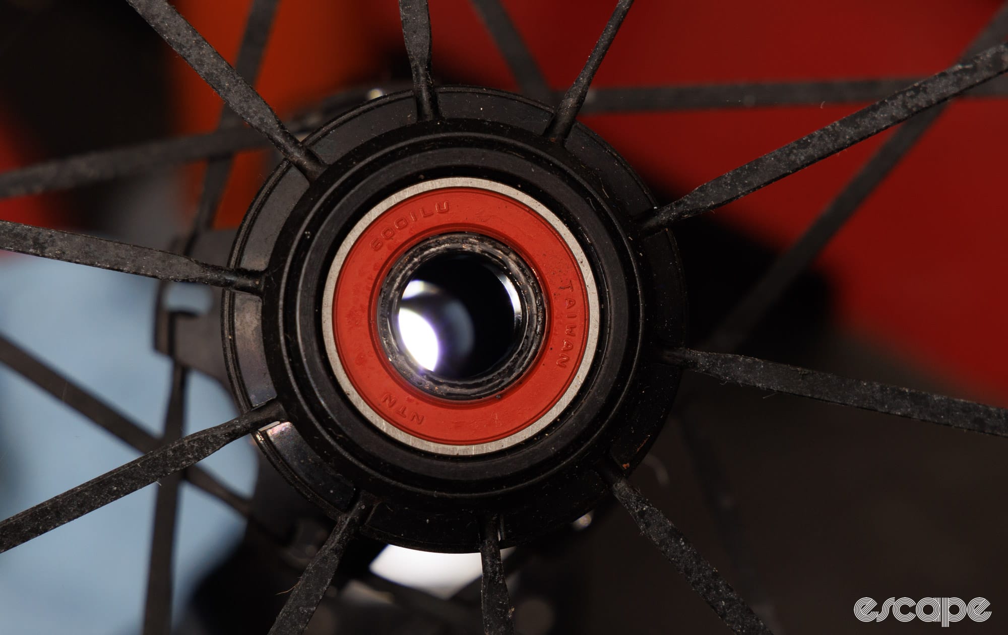

I won’t rehash my guide to smoothly removing cartridge bearings, but one increasingly common demand in modern bicycles is to remove a bearing with limited access behind it. Sometimes this limited access is due to the bearing having a preload spacer jammed up behind it, something commonly found in many freehub bodies, hubs, and main suspension pivots. Other times the bearing may be pressed up against a seat without much access from behind, common in a full suspension frame.
In these cases, it can be difficult, or even impossible, to employ the traditional method of a punch and hammer. Plus, that punch requires you to knock the bearing out edge by edge, risking dismantling the bearing and also potentially ovalizing or scouring the press-fit surface it sits within. The best method is to get that bearing out as straight as it first went in.

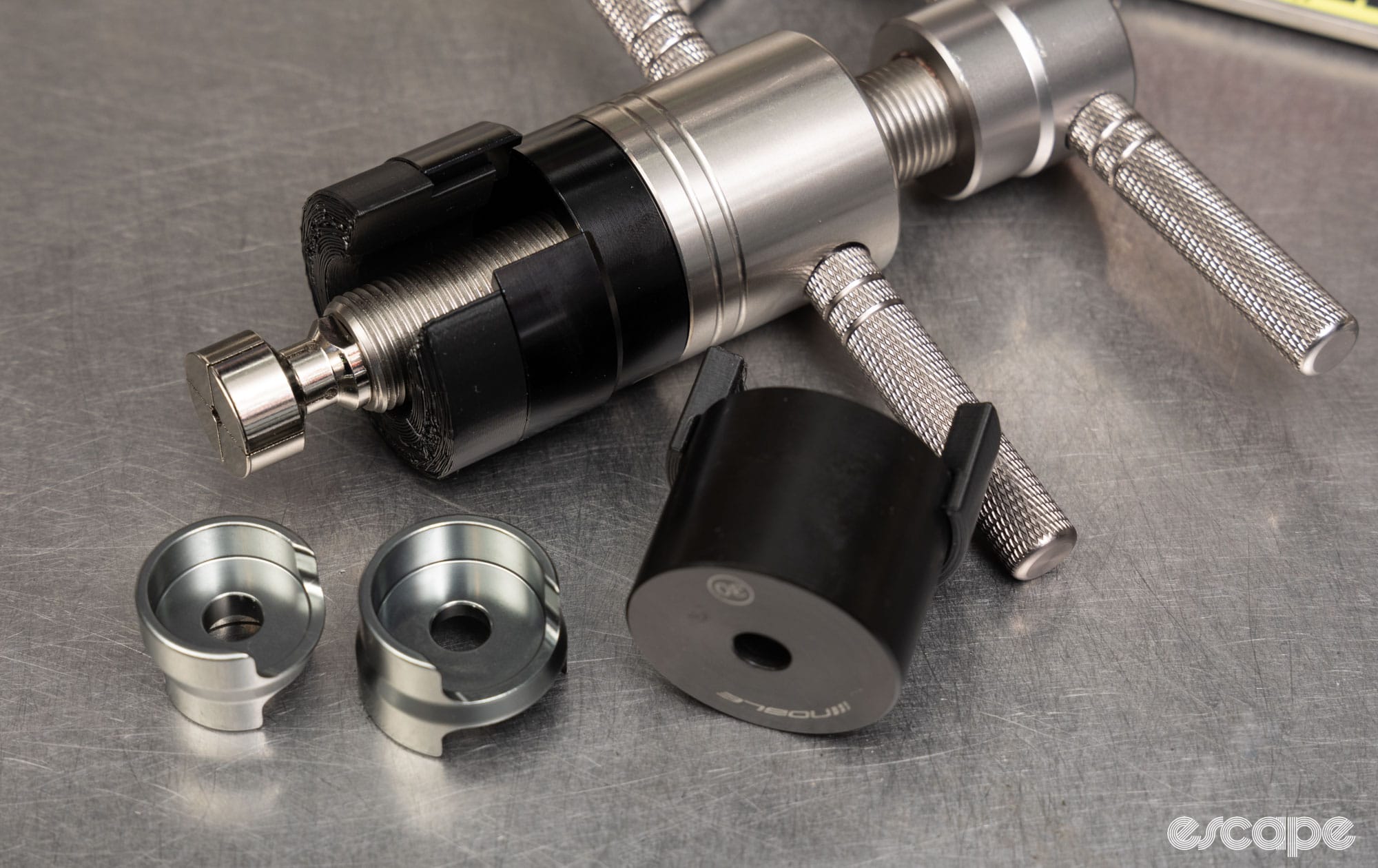

Top of that list is that if the tool works without a hammer or slide hammer, then it’s a thread-based puller. And if it’s pulling the bearing out, it needs a stable surface to push against. That surface needs to be flat and even, and while that’s a common trait in most hub designs, it’s not always the case for full suspension frame bearings.
If you need a blind bearing puller, but don’t have a flat surface around the bearing to push against, then it may be possible to use a cut-away puller cup that just contacts whatever flat surface is available – currently, most of these solutions are designed and 3D-printed as bespoke solutions by the end user.
Some examples of cut-away puller cups. Except for Enduro, most are typically 3D-printed.
For most mechanics, not having a flat surface to push against means the easiest answer is to use a slide hammer. Some of the tools covered here can be used as a puller or with a slide hammer, and so have more options than others. For example, one of the tools can be adapted for use as a puller, as a slide hammer, or as expanders that you then knock out with a punch.

Each tool has its own specific process, but the general theme is consistent:
  1. Select the right size tool that matches the inner diameter, and sometimes width, of the bearing.
  2. Select the right puller cup that’s marginally larger than the outer diameter of the bearing. Again, make sure there is a flat and even surface to push against.
  3. Expand the tool into the inner race of the bearings, ensuring it’s located squarely, just behind the race and not locked against whatever is beyond the bearing. This can often be felt with tools that offer a catch lip.
  4. Install the puller cup to rest against the surrounding area of the bearing. Once again, ensure it’s contacting a uniform, flat, and structurally sound area.
  5. Tighten the tool against the receiving puller cup.
  6. Marvel at modern engineering and scoff at those using a punch.
