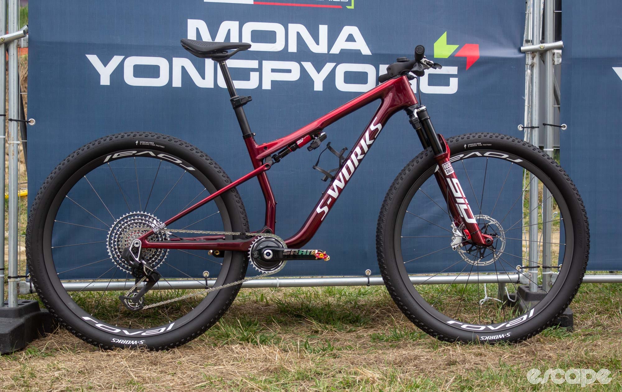

Haley Batten’s S-Works Epic 9
Just last week, Specialized released its new Epic 9 . The new bike borrows the headset routing and rear shock nestled in the top tube of the Epic World Cup, while the geometry and 120 mm front and rear suspension is more closely aligned with the Epic 8. Shaving weight was the key goal for the new bike, with the end result being a solid cut by over 200 grams to produce what's now the lightest full-suspension frame on the circuit.
This team-issue bike belongs to American athlete Haley Batten, featuring a build that you can more or less purchase straight from Specialized. It's equipped with Rockshox Flight Attendant suspension, SRAM's XX SL Transmission, and matching Motive Ultimate brakes. While the cranks feature simpler branding, Batten’s mechanic informed me there is nothing special going on there, and they are the standard XX SL crank with team-issue SRAM logos (something also seen with SRAM-sponsored WorldTour road teams).
One thing that does stand out is the S-Works Airtrak tyres. According to the team mechanic, these are a completely new casing as part of their Project Black prototype tyre program, with something special in the works. The new tyres are a 2.4" – a smidge smaller than the 2.5s the team was running last year.
