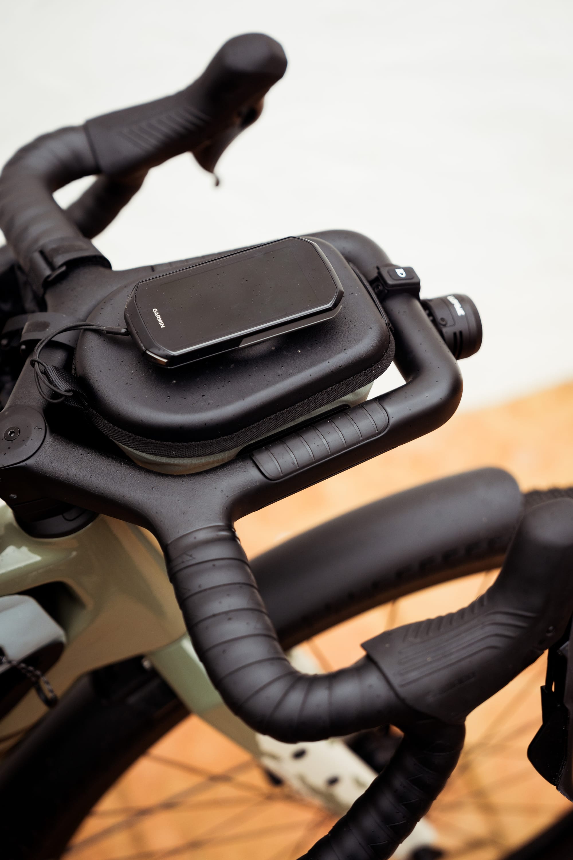

The short of it: If you are a bikepacking fan, the Grizl is worth considering. The new Full Mounty bar may solve issues common with conventional bars, but for some riders, it introduces new challenges. The DT Swiss collaboration suspension fork is sublime in use. However, the added complexity and servicing make it difficult to recommend without reservation.

Lows: The Full Mounty design can interfere with riding out of the saddle. For an adventure bike with a mullet groupset and suspension fork, the tyres feel like a limiting factor.

In simple terms, OG denotes a traditional two-piece bar and stem, and ESC means Canyon’s new Full Mounty one-piece cockpit, with comparable builds offered between the two ranges. The Full Mounty bar is very much a Marmite addition – likely to divide opinion, and the OG line is likely Canyon's hedge for those who don't like the flavour of the ESC cockpit.

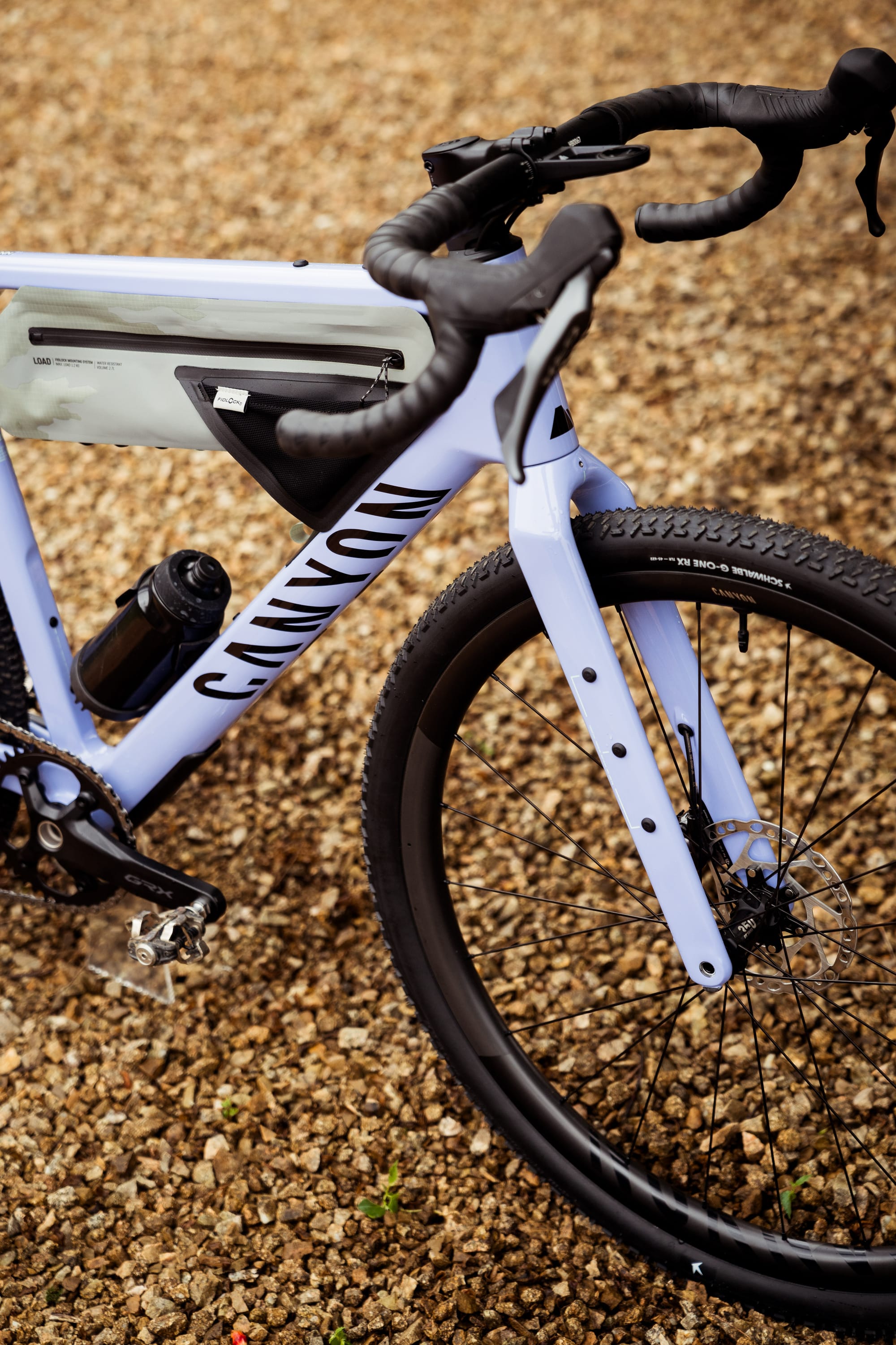

Aside from the obvious squishy update at the front of the ESC Rift models, the new Grizl range overall reflects Canyon’s evolving view of what the modern adventure rider is actually looking for. Tyre clearance has grown from 50 mm to a claimed 54 mm (with a few caveats, as we’ll get to), while the geometry has been comprehensively reworked to create a more relaxed riding position, lifting the front end and shortening the reach in the name of comfort and control on rough terrain. Canyon has also moved to semi-integrated cable routing to reduce frame rub when the bike is heavily loaded, though it’s a change that may give home mechanics pause. Rounding out the package are Canyon’s own in-house carbon wheels, reinforcing the bike’s shift toward a more integrated, expedition-ready platform.

Canyon is well known for offering a large range of sizes across its product catalogue, and the trend continues for the Grizl. The Grizl is available in seven sizes from 2XS to 2XL, claiming to cater to riders from 152 cm (5’) through to riders over 196 cm (6’5”). But in the geometry chart, the 2XS simply says it fits riders under 166 cm (5'5") which raises the question of how well that fit works for shorter riders, especially as all sizes now come with 700c wheels. For context, the average height for European women is around 166 cm, and 163 cm in the US. (The aluminium versions of the new Grizl add a 3XS size and uses 650b wheels.)
