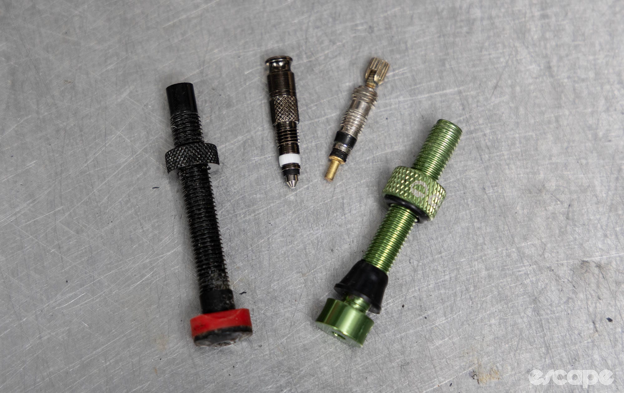

Clik (left) versus Presta (right). The valve cores are interchangeable.

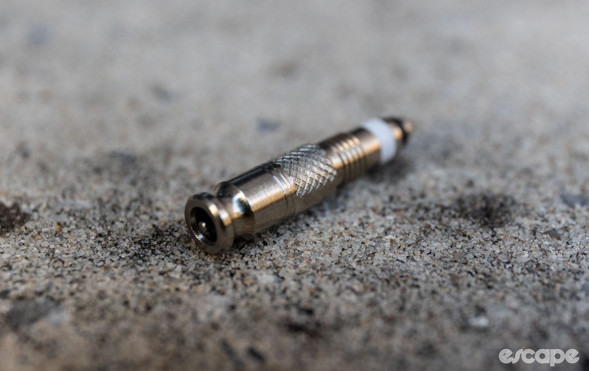

While you can buy Clik-compatible pumps, gauges, tubeless valves, or even inner tubes, the unique patented technology is contained to the valve core and corresponding pump head.
In many ways Clik is most similar to the Schrader valve where a central pin is pushed down to open the valve. When the pin is not engaged, a small spring plus the air pressure in the tyre keeps the valve closed.
Pulled apart. A tiny spring remains inside the valve core body.
However, there’s actually some clever design happening within a tiny hidden space. According to Clik inventor and founder, John Quintana, the “click” heard in using the valve is produced by two events happening almost simultaneously. “One is the tip of the valve hitting the end of the bore in the pump head. The other is the steel locking balls (within the Clik pump head) snapping over the radius of the groove on the outside of the valve and seating fully.”
“What’s innovative about Clik is that the pump head doesn’t seal on the outside of the valve stem at all. Instead, there’s a small internal pin, what we call the inflation pin or needle, that passes through a tiny O-ring inside the Clik valve core while also opening the internal plug. Because we’re sealing on a much smaller internal diameter of the inflation pin instead of the outside of the stem, the forces involved are much lower. That’s why it takes very little effort to connect and disconnect, even at higher pressures (it’s rated for pressures in excess of 150 psi / 10 Bar).”

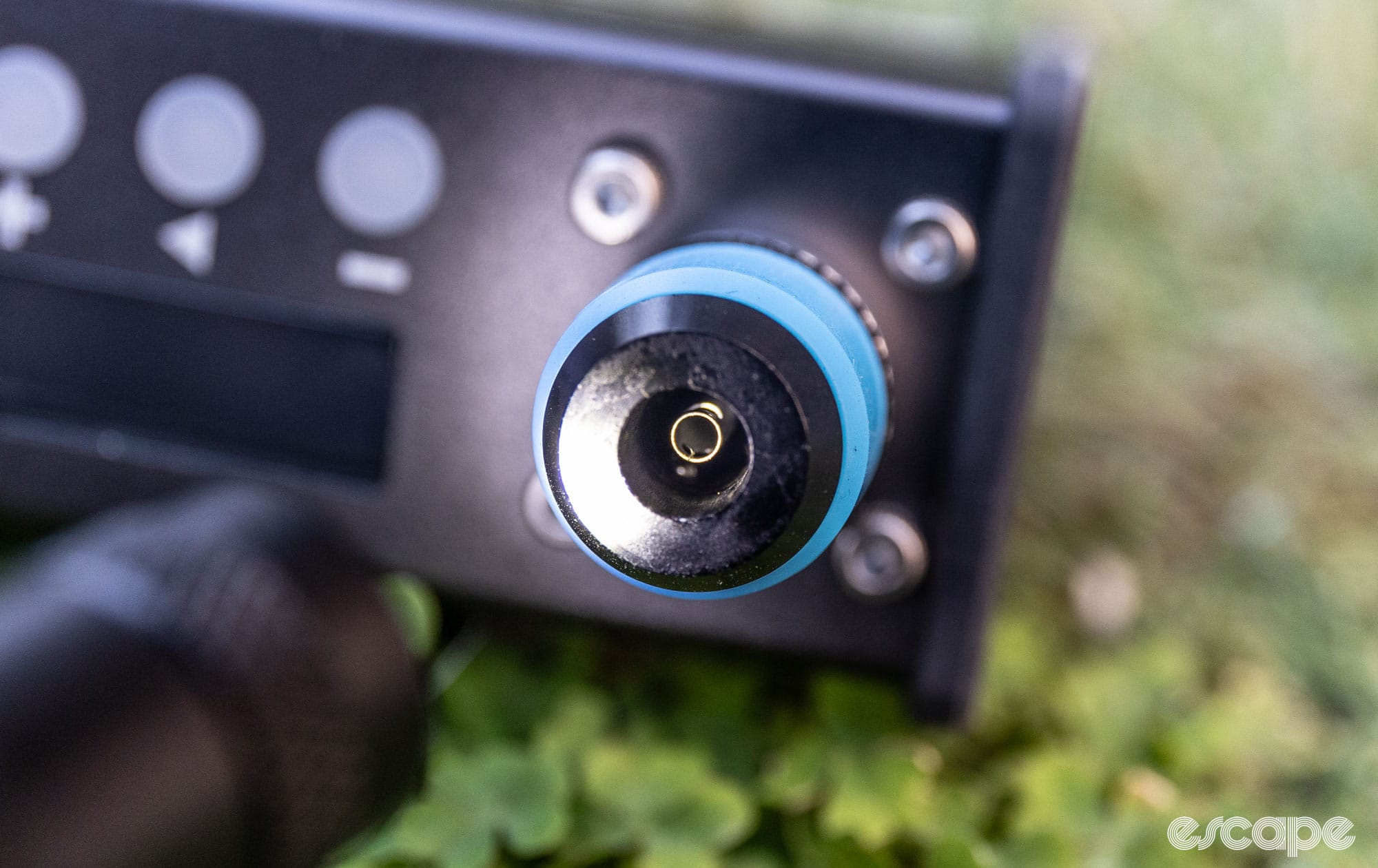

A look inside the Clik pump head. You can see the inflation pin, plus one of the detent balls that snap over the externally grooved valve core.
